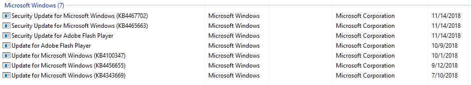

Same problem here, except I don't have 4462918 or 4462919, time to roll back updates one by one....Capture.PNG
Message 28 of 69
(3,780 Views)
Yes, the exact KB depends on the W10 version you are running. I still hope that Microsoft can do a forward fix. they must be aware of it by now. Breaking a decade+ worth of an installed base of commercial software should force some priority to this. You'd think!
