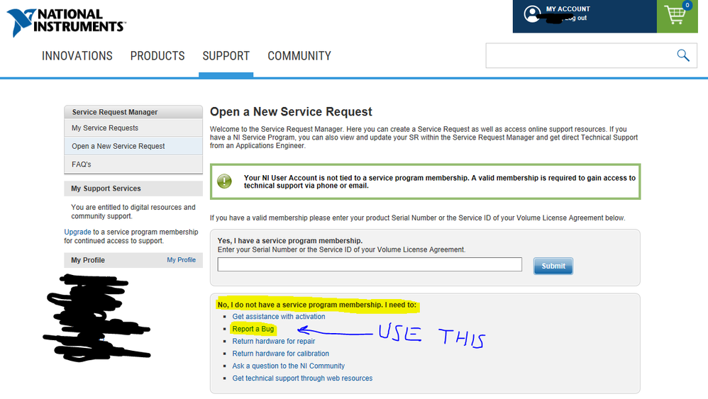

I was able to report this problem to National Instruments using the "Report a bug" link below. Hopefully they come back with a "bug fix".
