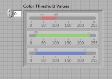

You're going to want to do this all in one run of the VI.  If you are inserting values into the db on the first run of the VI and then updating values during the second and third run, it's going to be a hassle and not intuitive to a user.
You need to find a way to define all 3 color thresholds at the beginning.  One way is to put the RGB selectors into a cluster and add them to an array.
Now when you search for the particles and get the coordinates, you can do that inside a for loop and auto-index the color threshold values.  So for each frame, you are going to have a for loop that looks for the first particle with the first color threshold value, get it's coordinates and add it to an autoindexed output.  Repeat for the next particle with the next color threshold value.  and again for the third.  Now repeat all of this again for frame 2, frame 3, etc.
aputman
Message 8 of 14
(4,409 Views)
Okay you are right. Thanks. But,I am not understanding which new for Loop you are telling to add. Can you Show me which part of VI or a small Code of what you meant? Thanks in advance.
Message 9 of 14
(4,405 Views)
Is my attached VI what you meant?
