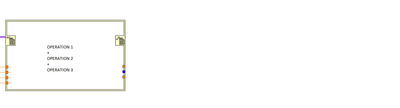

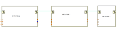

Hi everyone, I have a question about In-Place Element Structure.
I should use this structure into a time loop and in my application there are many cycles...so they compete with each other
I'm not sure if it's better to write the code like this:
or in this way:
from a logical point of view I think the first version is better. Is there a difference between the two uses? or is it the same? 

As always, it depends really!
Are you doing anything significant between the different IPEs? And I mean with significant something that takes more than a few CPU cycles! An add would hardly fall into this category unless it is on a large array. A single multiply neither, but many of them or on an array might actually be significant. A trigonometric function or any other non-linear function quickly could mean significant computation that could benefit from separating it out of the IPE.
Using multiple IPEs has some extra overhead as LabVIEW needs to acquire (and potentially arbitrate for) and release the semaphore protecting the DVR. But if you do any significant work between those IPEs, it gives other parts of your application a chance to access that DVR, so it may in the end result in a more responsive and performant application.
If there is no significant work being done between those IPEs or there is no concurrent access to the DVR however, multiple IPEs would only cause performance degradation.

To answer your question, we need to know where else you are accessing that DVR. Are some of these accesses "read only"? (This can be configured to allow parallel access!) Do all of them modify the DVR data?
The main purpose of the DVR IPE is to protect from concurrent write access, so while one is executing, access from all other parallel code (e.g. in other loops running in parallel) is blocked and these other code sections need to wait. Of course the locking mechanism is not "free", so if you lock and unlock three times in a row, there will be more overhead and if some other code section would grab access to the DVR between any of your successive structures, the code might stall for a while. It really depends on the overall program architecture.
If you constantly reading the DVR data elsewhere (read only mode), the upper code will have access to the intermediary values that exist between the three instances. Not sure if that is even desired. Performance wise, the lower code will be better. (1) only one access to the DVR. (2) all processing code in one structure allows more compiler optimizations by eliminating the artificial synchronization boundaries that exist if you have three isolated code islands.
Once you give a much more detailed description and even attach a simplified version of your code, we can give more specific advice. Is there a reason you are even using DVRs? How big are the contents?

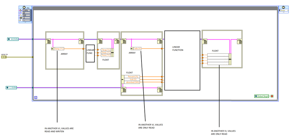

My M DVR consists of 22 clusters. In general, clusters are numbers and arrays.
the following VI modifies only one cluster (simplified version):
when I write "in another vi" it means that there are more than one VI
from what I understand it's not worth separating the IPEs because the overhead cost is higher than only one. in my case the array is very small (15 elements) even if the linear functions i think last more than a few clocks
I would put everything in one IPE. perhaps a read-only optimization could be done but not sure about the overhead cost

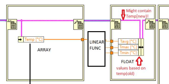

One glaring problem I see are also some sort of race conditions. For example if the "Temp" is modified elsewhere while the "linear function" executes, the cluster will have inconsistent values, with Temp(new) and [Tavg, Tmax, Tmin] based on Temp(old).
Maybe you should implement the linear function as a subVI (possibly in-lined) with only the DVR as input/output? Maybe not?
It is difficult to give advice based on tunnel vision of a single picture.
