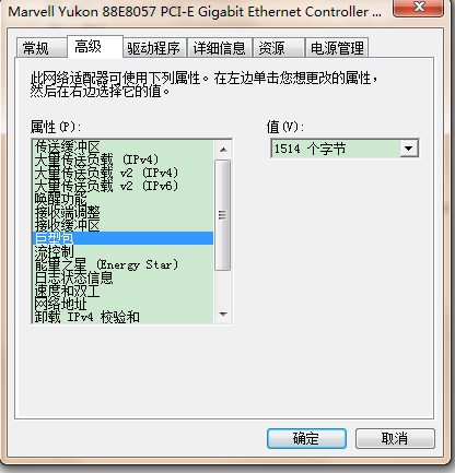

my ethernet card is Marvell Yukon 88E8057 PCI-E Gigabit Ethernet.how can i know my ethernet card support Jumboframes. my ethernet card setting like this
Message 4 of 11
(4,568 Views)

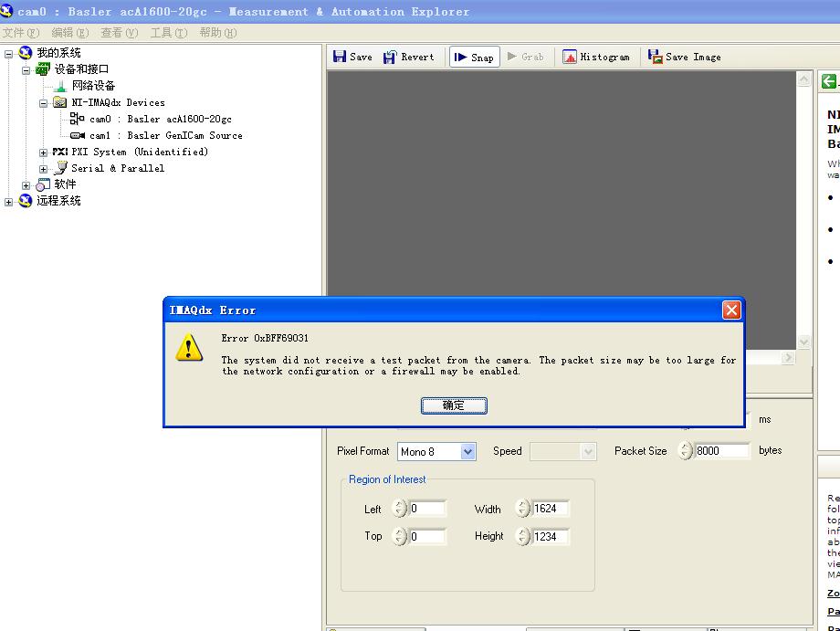

Select the Test Packet Enabled attribute and set it to be disabled the soft show a error
my soft seeting like this

In you NIC property panel, set the jumboframes to the highest value (ie about 9000bytes).
Regards

@Robert_Eastlund wrote:
There is a solution to the Test Packet Time Out Error located at http://digital.ni.com/public.nsf/allkb/8D9A975B04F66B728625768900805A21.
Hi Robert, this only applied to a very small number of the Scout series with a very specific firmware. The Ace and any other cameras do not have any bugs with the Test Packet functionality that require it to be disabled.
Eric
