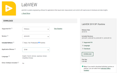

Because of caching issue, the f3 and f4 patches were not listed intermittently. Can you please check now?
Can you also share the feed list? "%ProgramFiles%\National Instruments\NI Package Manager\nipkg.exe" feed-list

The Runtime is still not available again this morning. I have attached the list of NIPM Feeds.
