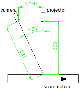

This part is dedicated to calculating the parameters of the scanning system and basic system design. In order to scan the object, I chose a stationary camera-projector system, where the object is subjected to motion. The relative motion between the scanner and the object can be used to preserve the proportions (i.e. spacing between the sequential scan lines) of the reconstructed surface. In this case the scanning speed/rate and the object motion speed has to be known. The scan line is also perpendicular to the motion of the measured object.
Figure 1 shows the rough sketch of my scanning system (not yet built, although I already have all the components).
Figure 1. Basic setup of the laser line scanning system.
The parameters were determined using the lens and triangulation equation. The sensor of my web camera is 1/3'' CMOS which equals to the physical size of 4.8 mm in width and 3.6 mm in height. I have calibrated the camera using the NI Vision Calibration Training interface and also determined the focal length of the web camera in real-world units. The calibration was real quick using only five images and I did not cover the entire grid. I will perform more accurate calibration at a later stage. The triangulation angle was selected based on the measuring distance (magnification) and scan resolution (dz). Figure 2 shows the calculated parameters of the system.
Figure 2. Determining the parameters of the scanning system.
I have also placed a band-pass filter in front of the camera lense to attenuate the environment lighting and pass only the laser light at 650 nm. The filter effect is visible from Figure 3.
Figure 3. Acquired image using a band-pass filter (left image) and without filter (right image) in the same lighting conditions.
