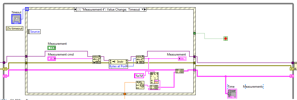

A small Rube...
Nothing to write home about...
Seen here...
Obtain measurement values...  Create a 2D array of strings. Take a double and convert to string. Format the string to string.  Append to the 2D array of strings ...  The Scan from string was used to remove the non-numeric values from the string...  (ie from: + 200 g the OP wants 200).
Since the desired measurement values are doubles, then why not just deal with that type, as below (which does not contain the entire code...  just to show the difference in the latter portion)

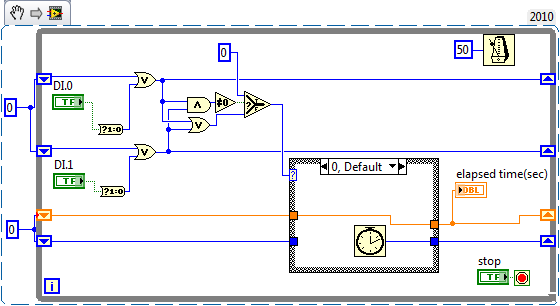

Somebody getting a bit caught up in boolean logic, then trying to make it easier by converting to numbers which are only going to be 0 or 1!
The VI is actually trying to determine the time between presses of two buttons, but it gets stuck after the first couple of presses - maybe the spaghetti gets caught in the cogs Smiley Wink
(Seen Here)
[Edit: included original thread - requested by Altenbach]
Do you have a link to the thread if this sighting?
EDIT: Ah, found it!
