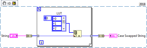

To quote Monty Python "And now for something completly different", how about using a lookup table with the UC and LC swapped in the LUT.

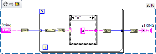

Or something even more differenter:
Why have the build array and byte array to string, just wire numeric to the case terminal.  It won't be as readable since it doesn't have ASCII mode but it does have Hex.

Even if you want the string for readability, the Rube Goldberg (built single element U8 array... Byte array to string) combo could be replaced by a simple typecast.

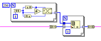

Yes, a LUT would be the way to go in deployed code. That's what I usually do.
(... But unless you want to create the LUT by hand, you still need one of our algorithms once :D)

@paul_cardinale wrote:
OK.  But I'm usually more concerned with speed that with size and this is about 30 times faster than this:
True, but the LUT is still 4x faster. You can even create it on the fly and it will be constant folded without any speed penalty. 😄

@Hooovahh wrote:
I just wanted to make something intentionally Rube Goldberg, I didn't mean for it to be a particularly "good" solution 🙂
On a side note, the FOR loop can be parallelized, but it makes it actually slower for smaller strings. However, for gigantic strings is a way faster that the same code with a plain FOR loop (e.g. 1k characters: 10x slower,  1M characters: ~4x faster, 10M characters: ~6-8x faster) (this is on an old 16 core dual Xeon)
