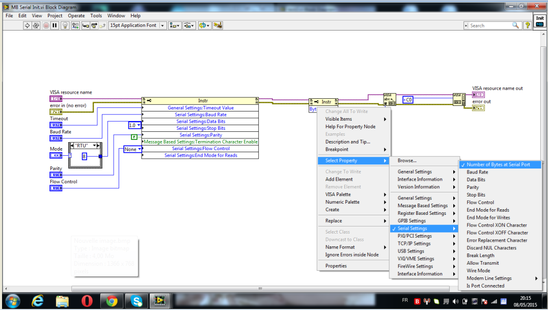

Hi
I restart every thing and I have this error from the "MB serial init "
look at the pic bellow plz
Message 84 of 86
(1,740 Views)
It looks like it's throwing an error on the flow control property. You could try removing that.
Message 85 of 86
(1,713 Views)
Hi Dennis Smiley Happy
the prob has fixed I just modify the  property
see the pic bellow
